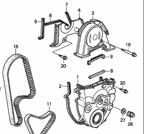

Again the set up on the 4th gen is a bit different than the 5th gen. In this pic, #27 is what I;m thinking is missing.
Thanks for the reply, and yes, I understand what you're saying. I'm just trying to get an idea of the bolt size so I know what size e-clip to get. It's ok tho. I'm sure I can just find a fastener assortment pack with a clip that'll work. I do appreciate the help. Thanks!
