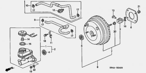

Desert, do you mean #14? My 02 Accord is having similar problems.

Old Oct 3, 2009 | 07:02 PM
Posts: 16,337
#14 is correct.

Old Oct 5, 2009 | 09:48 AM
Down inside the fluid reservoir is a mesh screen basket - pull it out. Sometimes that thing gets warped so it drags against the float. In that case, a new cap/float won't fix it. Check that out too.
