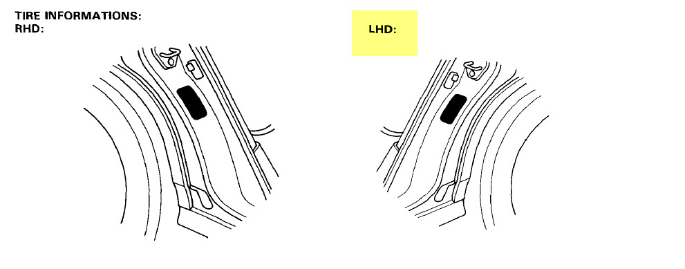

1. Tire pressure information is on a sticker on the driver's side door jamb. For a 4 cylinder, the recommended pressure (measured cold) is 32 psi (front), 29 psi (rear). Spare tire 60 psi (should be checked; but, less frequently. So, it is okay if you ever have a flat).
