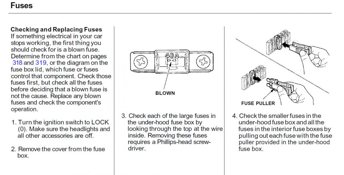

Check under-hood large fuses No. 41 (100A), No. 54 (40A), and No. 42 (50A).
There are two different type of large fuses in the under-hood fuse box.
Attached Thumbnails Car won't start and no power to anthing but horn.-underhood-fuse-box.jpg   Car won't start and no power to anthing but horn.-large-fuses.jpg
Thanks it was fuse 41. Your the BEST !!!
