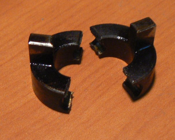

Now I've really got problems! Pulled the distributor out today, and found the coupling laying in the head - in two pieces!
Worse yet, I didn't see the pin retainer or thrust washer. maybe I'll stick a magnet in and fish around for them.
Can you buy just the coupling, and not have to buy a whole new distributor?

I may have to pull the camshaft/rocker arm assy to allow thorough examination. Hopefully you can retrieve w/ magnet.
May be a case of 180 degree misalignment again as the places stress on the distributor key which broke.
I can definitely vouch that this phubar is easy enough to do. I've managed the trick twice!

Thanks, I'm pretty sure it was a case of 180* out. Can you buy just the coupling/retainer, or do you have to buy the whole distributor? I just priced them - YIKES!
Old May 26, 2013 | 04:11 PM
Check ebay, amazon, rockauto for rebuilt prices. ebay and car-part.com are good sources for used.
You can find used for $30-40 and salvage part you need to repair yours. I don't think you can buy the part you need. Make sure part is re-installable w/o disassembling distributor. i seem to remember that part may only come off shaft from top end which will require lots' of effort to repair.
