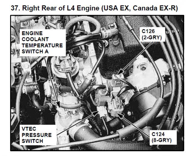

Test the relay, test thermo B (the one on the upper hose).
Old Jan 19, 2013 | 10:17 AM
Posts: 7,101
If the radiator fan run continuously without stopping after the car is turned off, it can be a problem with the radiator fan control module. The radiator fan control module is located behind the glove box.
Thermo-switch A will close above 199 degrees F and run the radiator fan after the car is shut off. However, it should stop after awhile, ~ 15 - 20 minutes.

Although the radiator fan relay can also be tested, you can quickly swap the radiator fan relay and power window relay to see if there is a change. I believe they are the same type.
