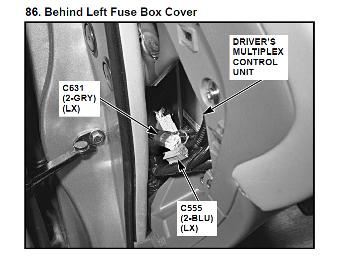

Ok, sounds like the person that hacked the wiring before was trying to get some lighting back after they messed something up. They possibly blew the Multiplex Control Unit (MCU) located in the driver's side fuse box. They did their own hack to restore some functionality.
Since it sounds like you reconnected the Red/Blk wire the way it should be, we'll go back to this same video I linked before.
Follow his instructions, if your lights come back on when you do this, the MCU is bad. Tell me what you find.

For your generation Accord, if it's the MCU, you don't need to replace the whole fuse box, just the MCU.

The jump test worked!
Full brightness in gauges!
So, I will just go back to the junk yard again tomorrow.
I just cracked the Clear lens on the gauge cluster, so I'll buy one of those, and they might just give me the MICU. (They have been doing that lately with small stuff they don't know what to call.) I can probably test it in the parking lot. its really an easy fix. All it takes is two screw drivers.
