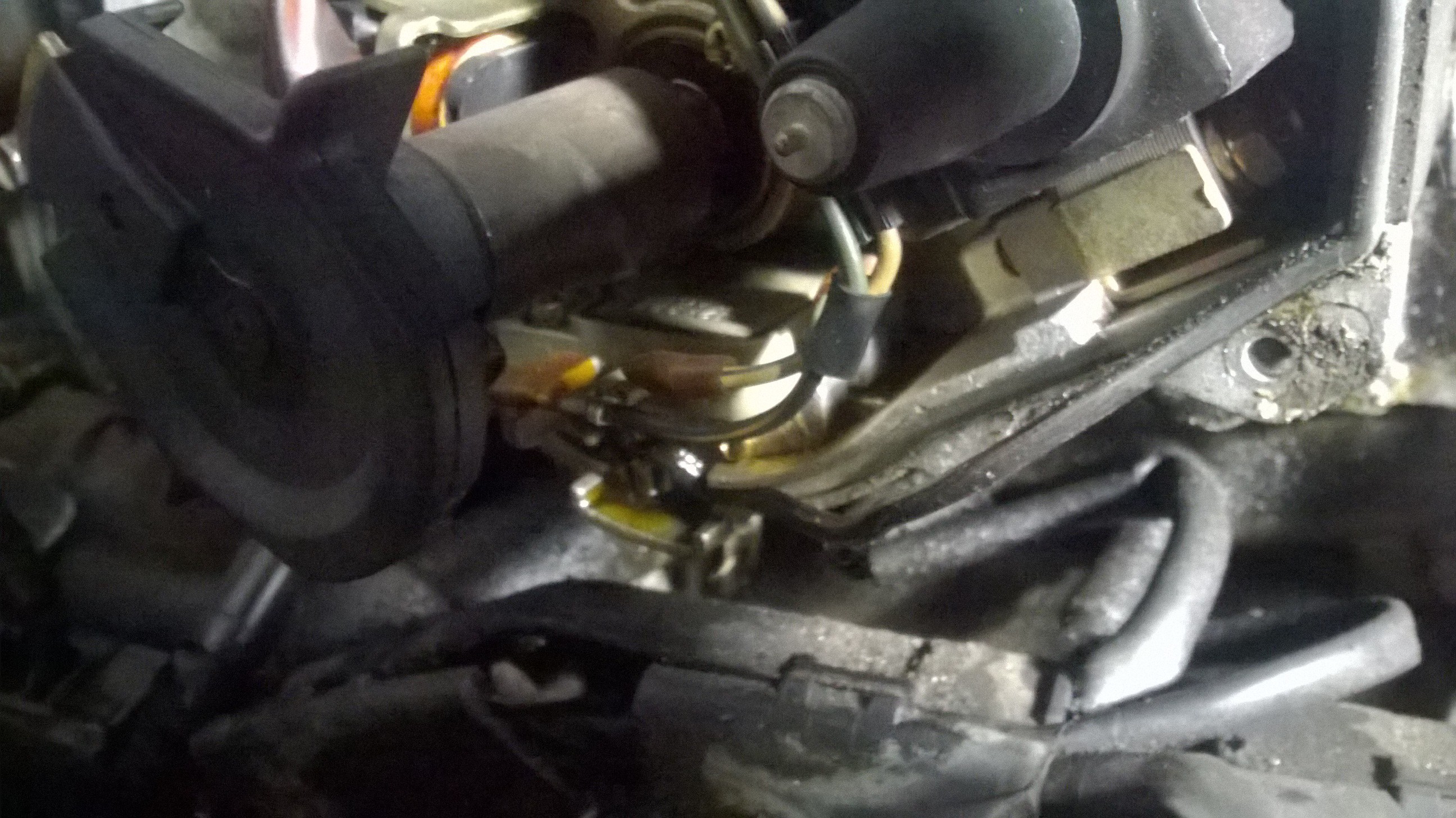

I have what is likely a distributor o-ring leak, with all the oil beneath it. I also have a simultaneous vtec solenoid leak. Some UV dye, blacklight, and UV goggles can help trace and it was helpful for me, as gravity can confuse tracing the source. Anywho, pics.
The first shot shows oil at the base of the distributor. The second and third shots show what was causing the leak. Aged O-rings/gaskets harden and eventually allow oil to seep past where they used to fill in. That means they have to be broken off (carefully).
I was lucky the distributor internal shaft seal was still in usable condition. There's a presence of some oil at the shaft, but the inside is pretty much dry. (not shown)
The fourth shot shows the block with the distributor removed and all the oil degreased off the lower hose and switches. Before, it was full of dirty oil. When I first removed the distributor, I had to plug up the hole as oil seeped out.
Like poorman said, taking the distributor off requires aligning the rotor and housing, meaning TDC and the cylinder mount respectively. The 5th shot shows where the rotor and TDC for sparkplug terminal #1 align. Before the distributor housing is taken off though, guidance says to mark the body with the cylinder mount. I would assume if that wasn't followed, it would affect timing. But that's a whole other post.

Well this is over a year ago, but that's good information for people who find this thread by searching.
I'd like to add one more thing to check. In your 4th photo you can see the split line between the head and the cam-bearing-cap. That basically forms the bottom & top halves of the hole for the distributor. That bearing cap is installed with sealant, and if the sealant is not sufficient oil can leak out through that split line.
