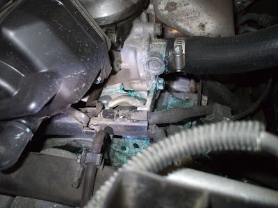

Originally Posted by Neptun3
When I drive my 1996 Honda Accord the transmission slips or shifts hard when changing gears. I am not sure what the problem may be but about a month ago I had a bad distributor that was leaking oil onto the transmission. Can this cause problems for the transmission?
I wouldn't rule out that if external trans components get dirty or oily that it might be the source of the problem. I had an instance for several days that my trans wouldn't shift. It hung up and didn't shift out of second and third, up until 4500+ RPM. I thought the trans was blown out. I even called around for estimates.
At the time, the coolant was leaking onto the connectors on the shift solenoids.
I got the coolant leak fixed at the dealer for 1/2 hr labor ($48) and the trans has been wonderful ever since.
But please drain/fill the fluid with Honda fluid. I have been getting mine done every 20k miles or so.
Attached Thumbnails 1996 Accord - Distributor Leaking Oil Onto Transmission - Causing Slippage?-dscf1442.jpg
