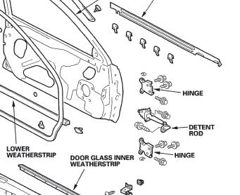

Should be two hinges and one "detent" rod. I would start with lubing those, working the door back and forth (don't have to fully open and close but move it) to get the new lube into the hinges and rod.
