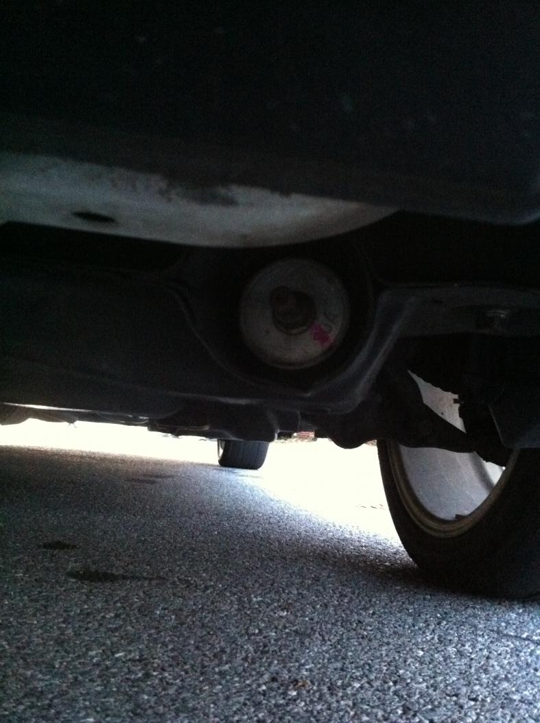

when i had my clutch kit replaced they lost this part now im trying to find out what is the name of this. thank you. . this is in fgront of the car underneath the engine bay. i think it holds the front frame of the car. thank you

It is part of your front multi-link suspension. It prevents your suspension from moving backwards when your tire hits things like a pot hole.
Behind the brass plate is a rubber dampener to absorb impacts.
They shouldn't have taken this out, if you don't have the brass washer then go back to them and tell them
Judging by the photo you aren't missing anything

they removed it so they can take the transmission out, we'll the mechanic did a crappy work on my car it was kinda bad on my part. yeah the brass washer is missing on the other side do you know where i can buy these?

junk yard or honda? why not tell him to figure it out?

Just me but I'm trying to figure out what is missing? That is a pic of the strut rod bushing...or since this is the drivers/left, is the pass/right missing.....
EDIT: aka as the radius rod bushing
