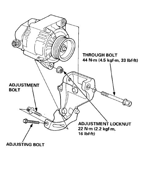

Not sure if this pic will help or not?
If they got the balance shaft timing off - then you could have a strange vibration.
I would still check all of the mounts to be sure that one or more is not broken.
