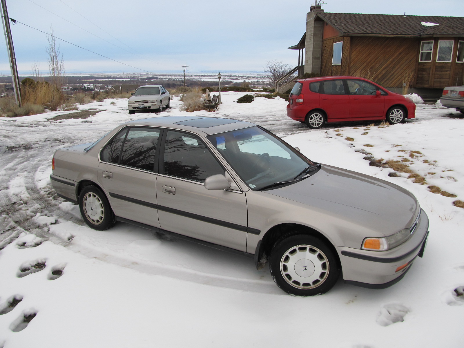

SOLD IT. I'd had a '93 Accord LX 5sp for 5 yrs, been a good car. comfy to drive, too. 235,000 miles.
My son needed a car last month on urgent basis, so he's buying it from me for $75/month.
Darn that was a good car. So I'm looking for a replacement and I see the exact twin, even same color,
only an EX with sunroof/ABS/4 wheel disc brakes - 1992 @ 201,500 miles.
Impeccably maintained, I bought it and it's virtually the exact same car I sold 3 weeks ago, only better.

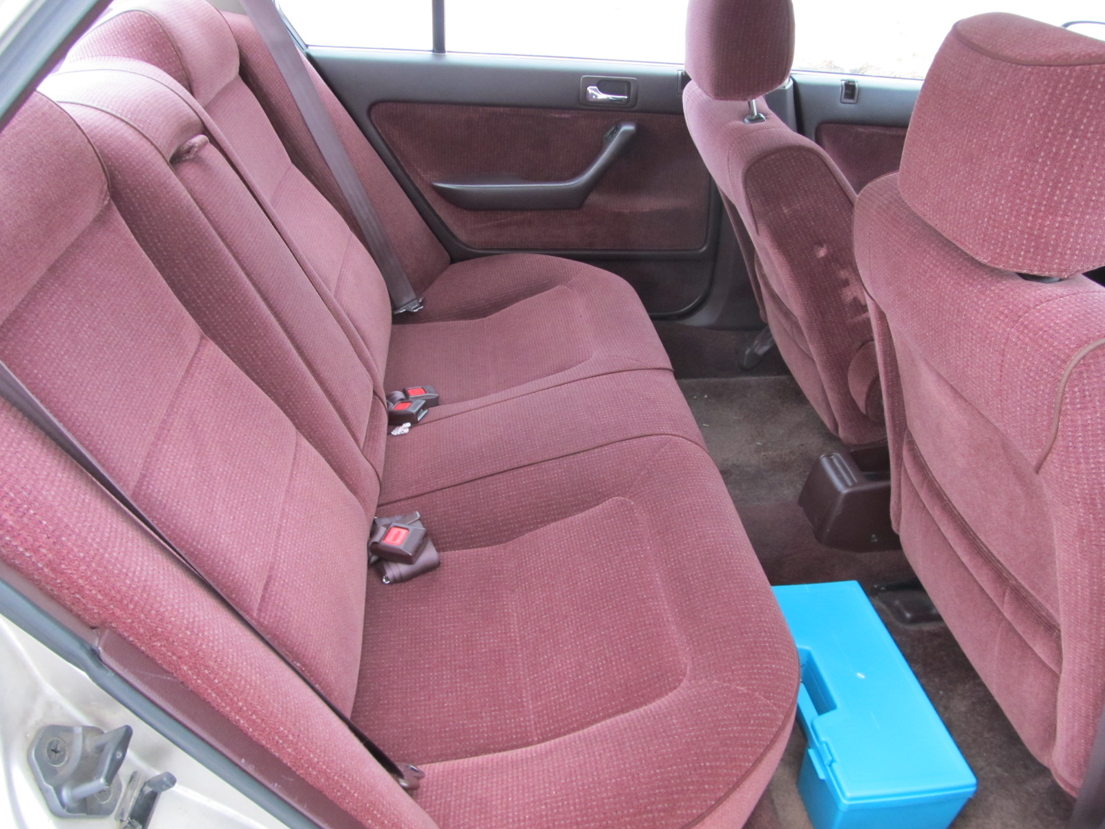

Back seats look like they've never been sat in...

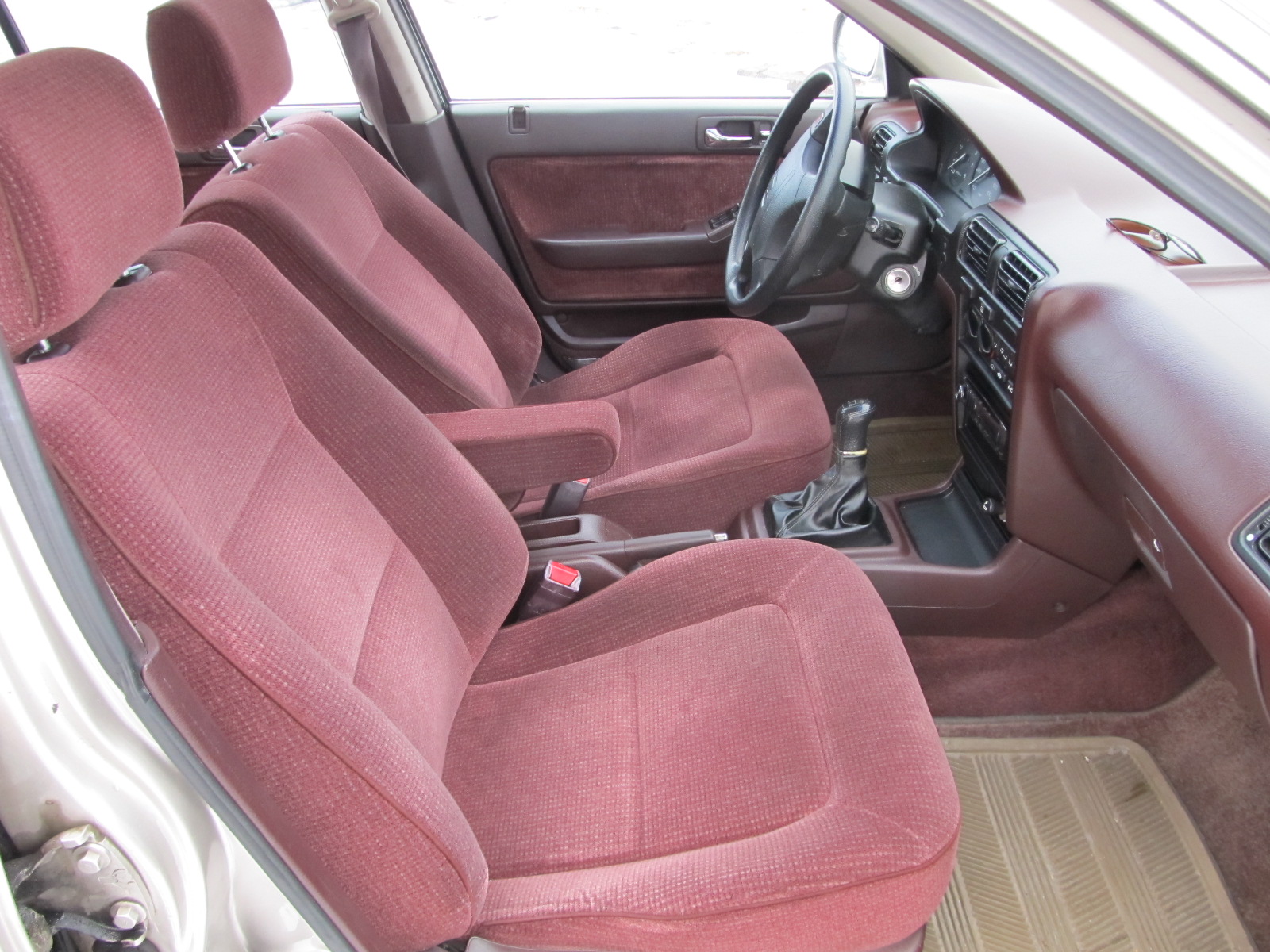

front seats very nice, too.
