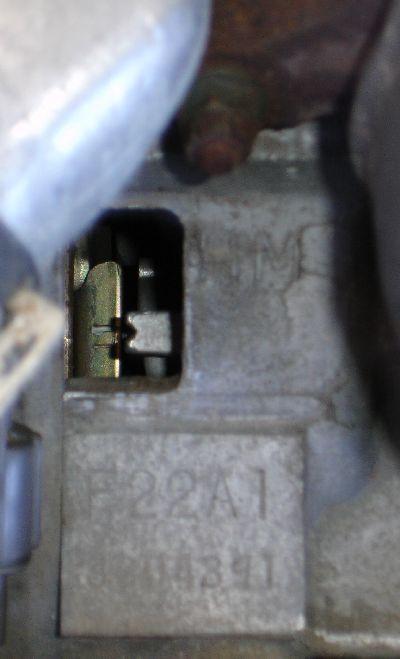

The easiest way to find TDC is to remove the plug from the access hole right above the engine ID. This is close to the front motor mount where the engine and transmission meet. See pic below.
Use a 19mm deep socket and turn the engine to TDC by turning the crank pulley bolt counterclockwise when looking at the bolt from the driver's side tire.
That notch on the flex plate will line up with the marker on the right when you reach TDC. When the marks line up, remove the distributor cap and see if the rotor is pointing to the cylinder with the #1 wire. Going in a clockwise direction looking at the car from the passenger tire, the firing order should be 1, 3, 4, 2.
