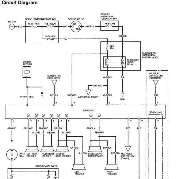

See if this helps.....Drivers side #8 and pass side #9 fuses. Then yes, the relay.
Attached Thumbnails I'm having a big problem here!!!-6th-gen-radio-power.jpg
