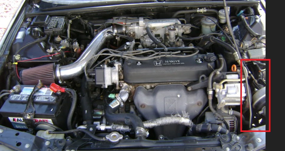

There's also this mysteriously disconnected cable in the bottom right of the engine compartment floating around, that is connected to the trhottle. There's a little bit of space there, but I would have no idea what'd be originally connected.

It may help to post a picture, but it sounds like the cable you are talking about went from the throttle body to an automatic transmission.

In the meantime, this is someone else's 90 accord lx coupe, and this is exactly what seems to be missing from mine. It's a bit cut off in the photo, but perhaps you can make it out?

That is the cruise control actuator.

Awesome, also explains why cruise control wasn't working (though I don't care).
