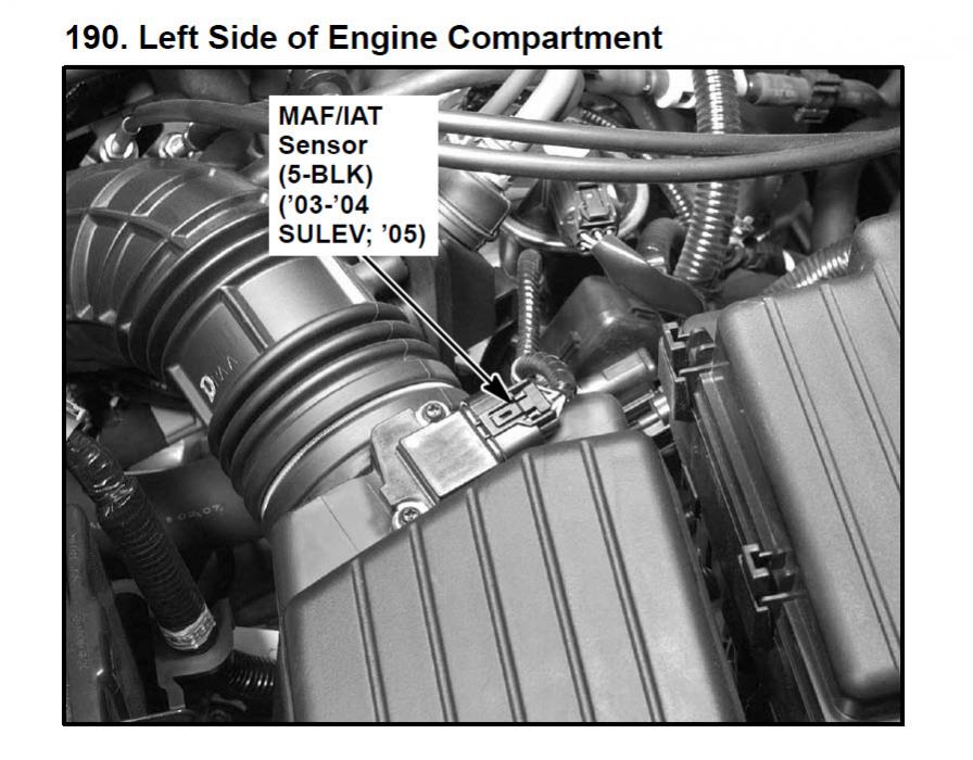

The P0171 can just be the Mass Air Flow (MAF) sensor being dirty. Check the condition of the air filter and gasket. Then use some MAF sensor cleaner spray (CRC makes it) on the sensor.
https://www.hondaaccordforum.com/for...iat-sensor-jpg
