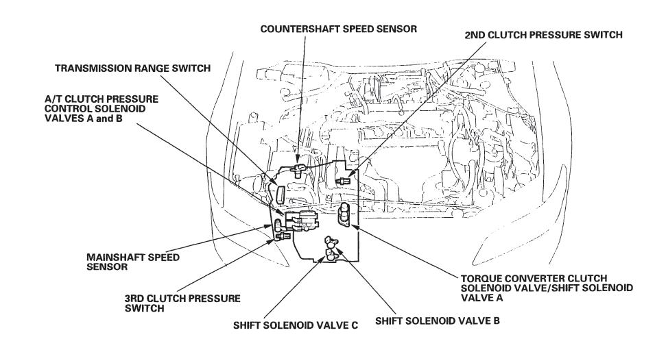

The trans does not have to come out to get to the solenoids (clutch pressure a & b). You can try removing - replace if you are up to it - and cleaning them.
The auto trans in this gen are not that good...so it is hard to say if this is a sign of the end?

Thanks for the attachment, now I'm 100% sure I was trying to remove the right part. Haha
