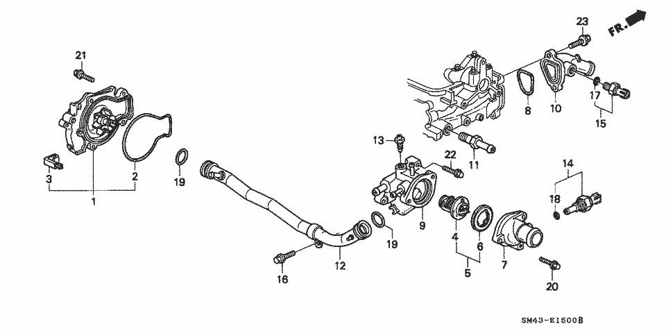

The air-bleed screw is #13 in the picture. It has a hole through it, looks kinda like a brake bleed screw.
But like Dr.D says, it could be a few other things like ignition.
