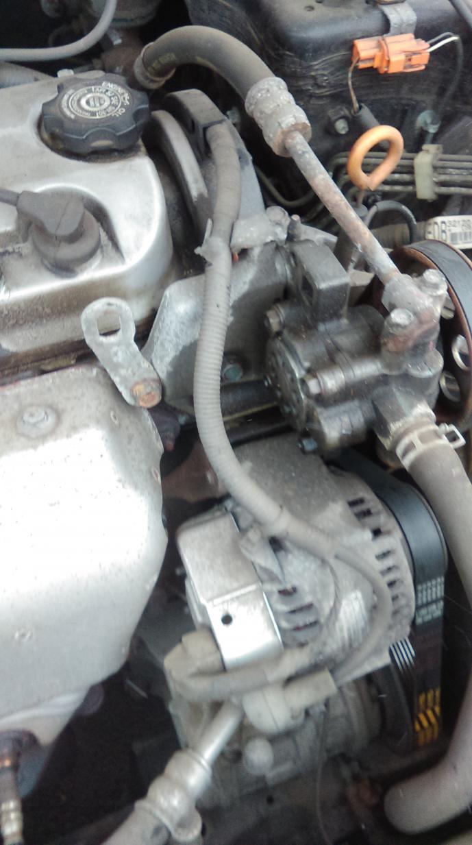

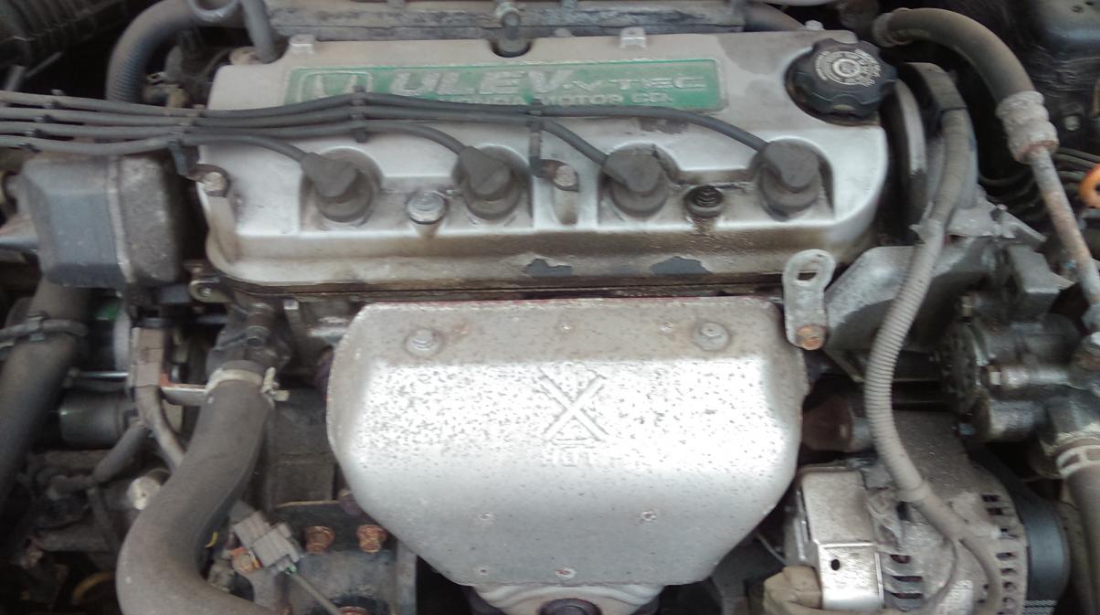

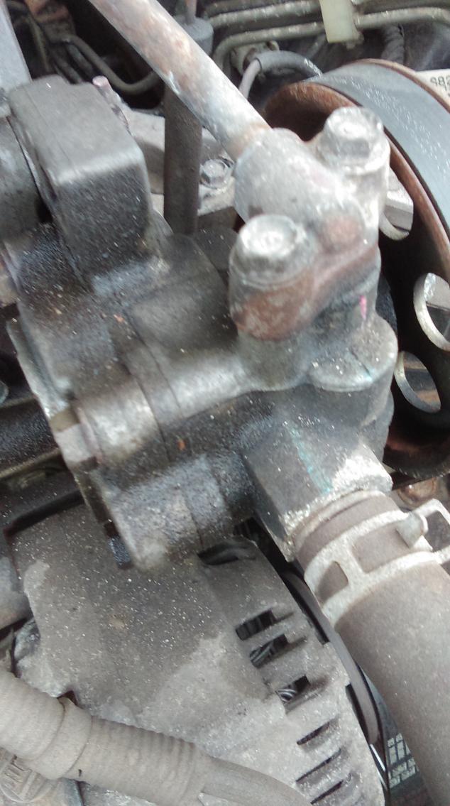

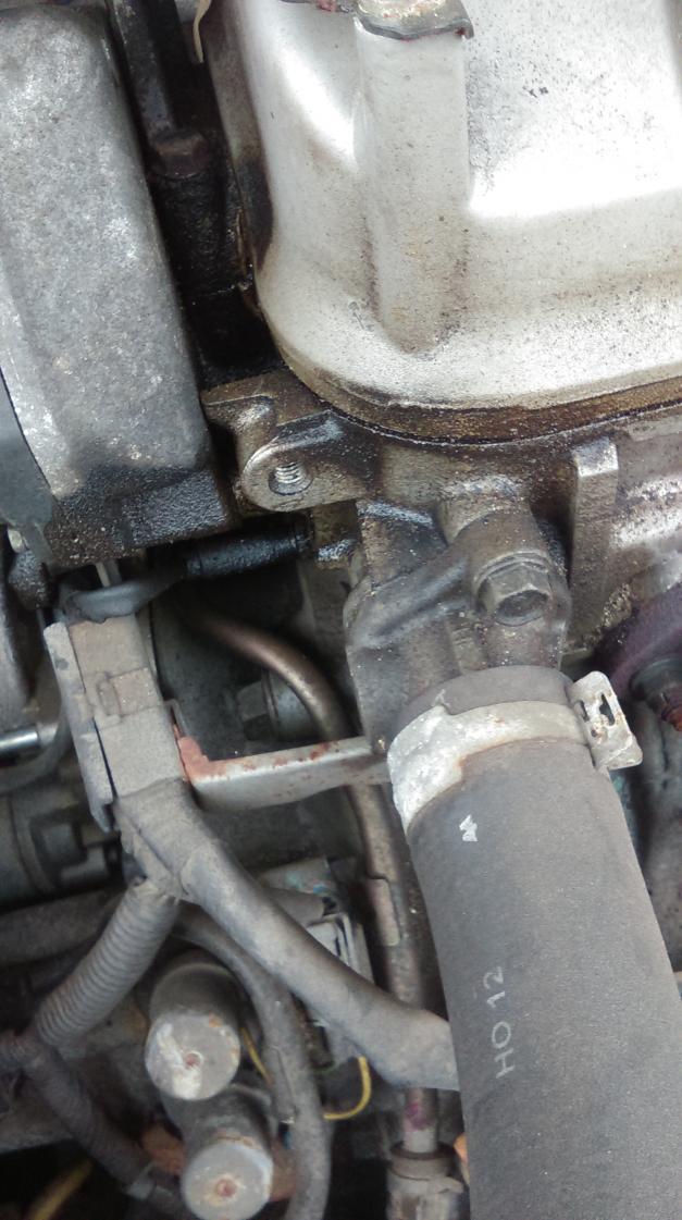

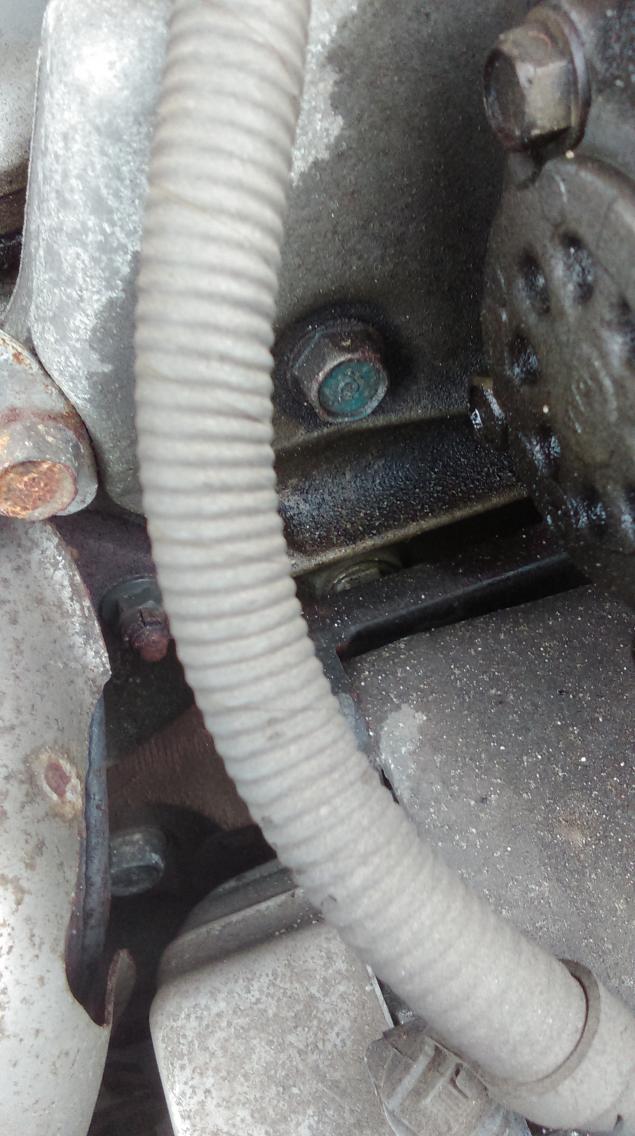

Check these pics out. I'm thinking a leaking valve cover gasket, but what's with the oil all over the alternator? Car is not overheating, but burning smell coming from engine.

Looks like possibly several leaks; distributor shaft/head oring, valve cover gasket, PS pump (Looks minor).
New valve cover gasket kit, new distributor shaft/head oring.
