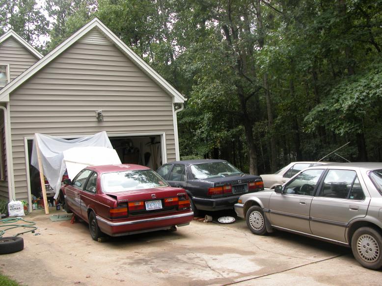

Ony pic I got was this one....the boy was proud of the "lean to" he built-it was raining when we started.......hey and I see it has the four 3rd gens and just a "tad" of the Chevelle...not sure where the 95 and Pilot was.
