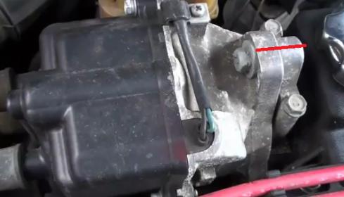

Old Apr 8, 2011 | 07:00 PM
Posts: 16,334
If there is no oil inside of the distributor, then you just have to replace an o-ring.
You will have to remove the distributor to do this. Just mark a line across the distributor where it bolts to the cylinder head on to the cylinder head. You do this, because the distributor can rotate to adjust timing. I put a red line on a pic of a Honda Distributor to show what I mean. By marking the distributor, you do not have to set the timing. All you have to do is to line up the two lines when you reinstall.
