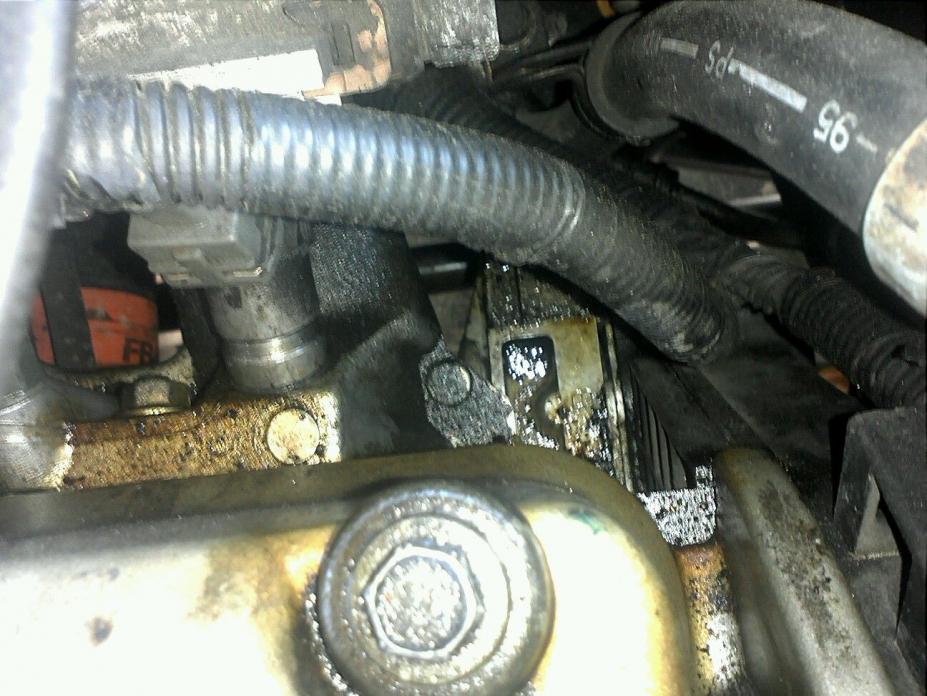

Sorry to bump this thread but I have a 95 accord and I am having the same issue. I have oil pooling right behind the valve cover gasket. (Pictures attached). So after reading this thread I just want to make sure I am understanding what is happening. The oil in the top of the engine isn't able to retreat back into the oil pan due to blocked passages, hence why the oil is leaking from the gasket on top of the engine. It makes sense, I just want to be sure I understand it right, and if the fix for this is an oil and oil filter change then I will do it right away. Thanks for any help guys.

Hard to call but it looks like the valve cover gasket is leaking and needs to be replaced.

Okay. I changed the oil and filter yesterday so I will check and see if it is still leaking but I will probably go ahead and replace the gasket anyways. It's only a few bucks and its fairly easy to replace.
I want to pose one more question. The bolt that holds the oil dipstick in is sheered off. Could oil be leaking from a loose dipstick? Thanks.

The oil dipstick tube actually enters the engine at a much lower elevation - down at the oil pump. So leaking from there wouldn't get up to where you see the pooling.
Still, you should try to extract/replace that bolt, or do something to fasten the dipstick tube so it doesn't vibrate & come apart.
