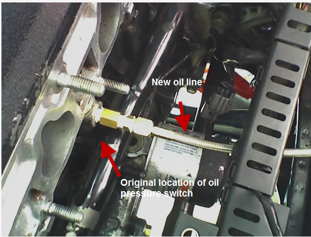

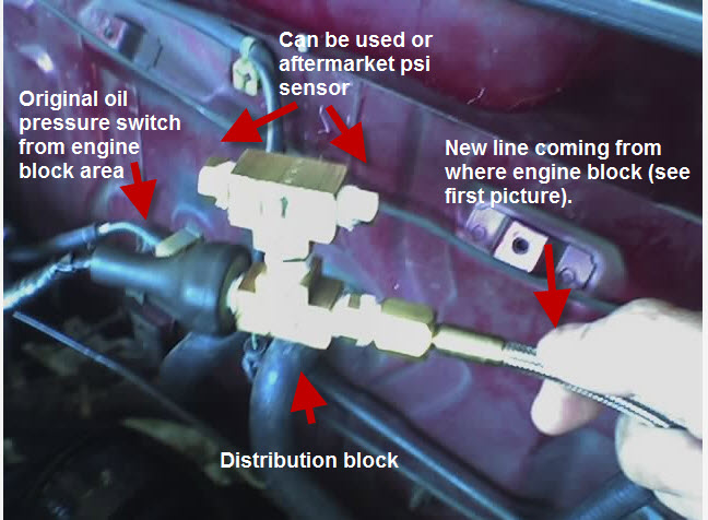

I have a 95 accord ex 2.2 auto vtec. I wanna mount a oil pressure gauge and possible a volt gauge somewhere on my dash seperate somewhere, cause I don't have either . The volt gauge is not a problem I can hook that up anywhere. But I'm unsure how to hook the oil pressure gauge up or where to hook it to get my reading? Any help please?

I still don't really understand exactly all I'm supposed to do. I looked in the DIY section on both forums I'm a member on both and there is no step by step directions. Is there a easier way? Looks like he took his intake manifold off... is that a needed?
Old Dec 2, 2012 | 02:52 PM
I added some notes to the attached pictures; this looks like how it would work. There should be no need to remove the intake manifold, he must have been doing something else too.
