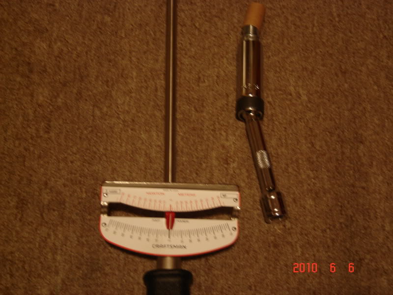

I used a 3/8" drive beam type torque wrench (pictured below). It doesn't ratchet, and you have to read the dial while turning, but really all you need to do is get one bolt tightened with the torque wrench, then get a feel for how tight they need to be using a regular ratchet. It is important to tighten them in two or three steps, so the pan goes up even all the way around. I used it to install the transmission pan on my truck, and everything turned out well. I use it for installing spark plugs too. I have a 1/2" drive for more torque.
