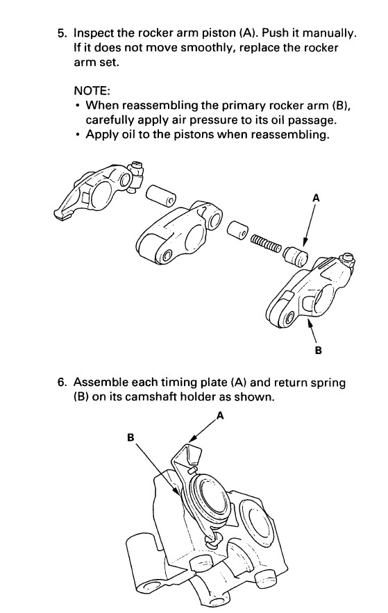

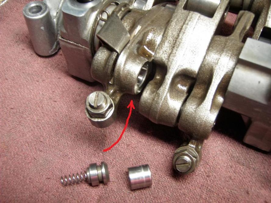

SO, my question is, where can i get these pins? I can not for the life of me find them, and I can not afford top buy for new rockers. Anyone have any ideas? I will attempt to add pictures of the pieces I am missing
In the picture, Youll see a small spring, a small pin (cylinder) and the little piece the spring appears to be attached to (call it the notched pin).
In short, I am missing four notched pins, three springs, three short rollers and one long roller (about twice the size of the short one in the picture)
The second attachment shows the assembly. It better illustrates the four pieces. Someone please help me find these bad boys. Thanks a million guys.
