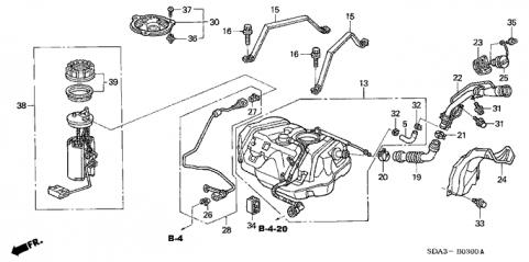

Old Mar 19, 2013 | 12:57 AM
Are you referring to part #28 in this image?
Attached Thumbnails Pin hole leak in fuel feed line @ pump-fuel-tank-1-465395.jpg
Old Mar 19, 2013 | 01:03 AM
BillHinek's Avatar
Joined: Jan 2013
Yes, it is no. 28.
the parts breakdown answers my question,
It appears I will have to replace the full line and purchase the quick connect fitting retainers
in replaceing the line.
Thanks for the excellent parts display.
Bil
