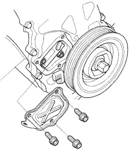

Try to rule out external stuff like rattling bearings in idler pulleys, waterpump, stuff like that. But the location sounds like it could be the timing chain. There's a way to remove a small cover & look at how much the chain-tensioner is extended, but I don't remember the details (daughter used to have a 2003).
this the one jim?
Old Jul 26, 2013 | 10:17 AM
That's the one. The details I don't remember is what you measure exactly, and what's the pass/fail length on that measurement. It's all in the factory service manual (which I sold after we sold that car).
Another thing to worry about, is whether the chain guides can come loose or come apart??? I don't remember if that's a possible reason for the rattle.
