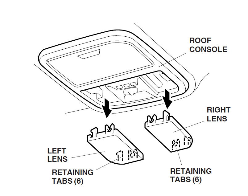

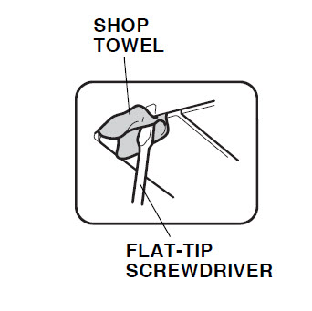

For the 7th (2003 - 2007) and 8th (2008 - 2012) gen Accords, the map covers can be pried off by hand or by using a small flat head screwdriver. You can use a shop towel to prevent scratches. The retaining tabs on the lenses on the 7th gen Accord is only slightly different from the 8th gen Accord. The attached picture shows the 7th gen Accord lenses. There is no need to remove any screws.
Attached Thumbnails Reading Light Replacement-lens-removal.jpg   Reading Light Replacement-shop-towel-screwdriver.jpg
