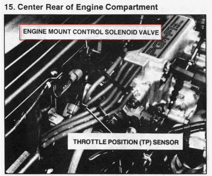

How do I determine which rear motor mount to buy (with or without solenoid) for a 92 accord dx auto. I could not determine by looking in the engine compartment. Do most of these cars have the Solenoid type? Car was manufactured in Japan.

Usually the "auto trans" cars have the vac controlled rear mount.......has the solenoid.
You can get under the car - use safety. if there is a vac line going to the mount, that will confirm it came with the solenoid.

You should be able to see the engine mount control solenoid valve and the vacuum lines running to the mount from the top of the vehicle. Attached is a photo of the location of the solenoid valve.
Attached Thumbnails Rear Motor Mount-engine-mount-control-solenoid-valve.jpg
