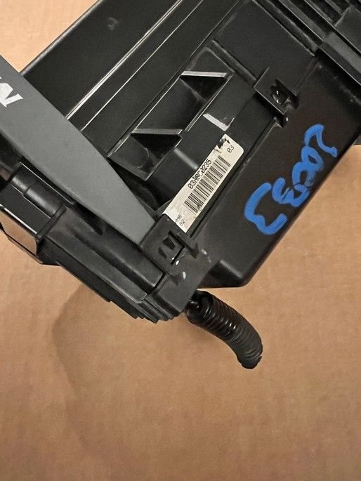

Closeup of fusebox bottom cover clips on right side (2 on this side)

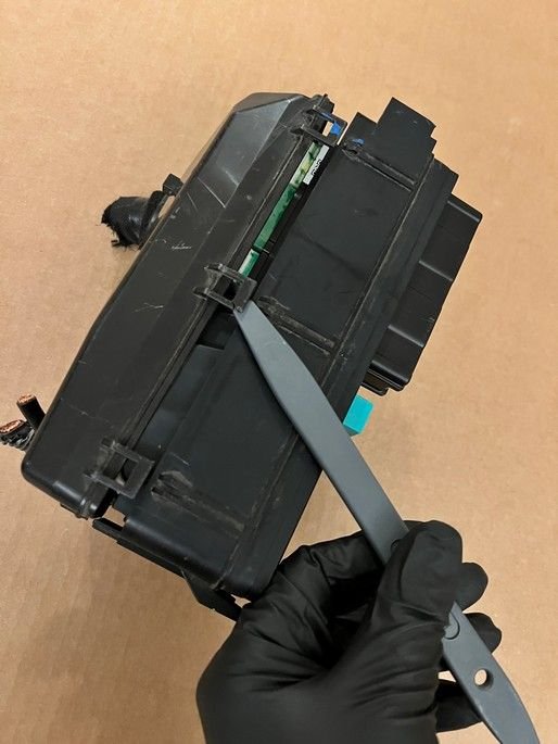

3 clips on left side. 1 more clip on rear not shown. 6 clips total hold bottom cover to fuse box body.

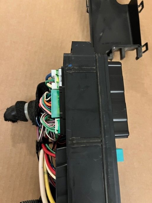

Fusebox bottom cover will drop down. note bottom cover curves around main wire bundle. Hard to see when fuse box is in vehicle.

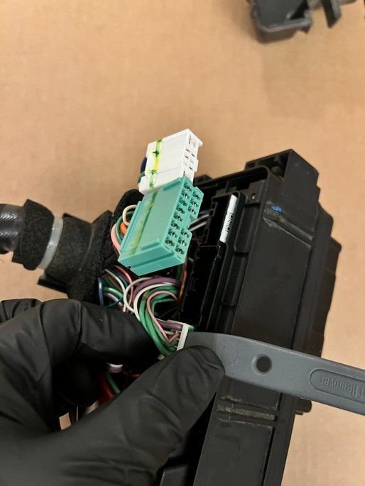

3 connectors (from top of photo to bottom - white1, green, white2) connect to bottom of 38830-T2A-A01
3 connectors (from top of photo to bottom - white1[Connector A], green[Connector B] , white2[Connector C]) connect to bottom of 38830-T2A-A01
Depress retaining clip on white1 connector while guiding trim tool to stay on connector lip
Detail of white1 connector retaining clip location.
Same with green connector. Depress retainer clip in center of connector while guiding trim tool along the connector lip to gently release the connector.
Detail of green connector retaining clip location
Repeat process with white2 connector
Detail of white2 retaining clip location
From top release the 2 retaining clips of the relay module.
Remove 38830-T2A-A01 without any strain on wires.
