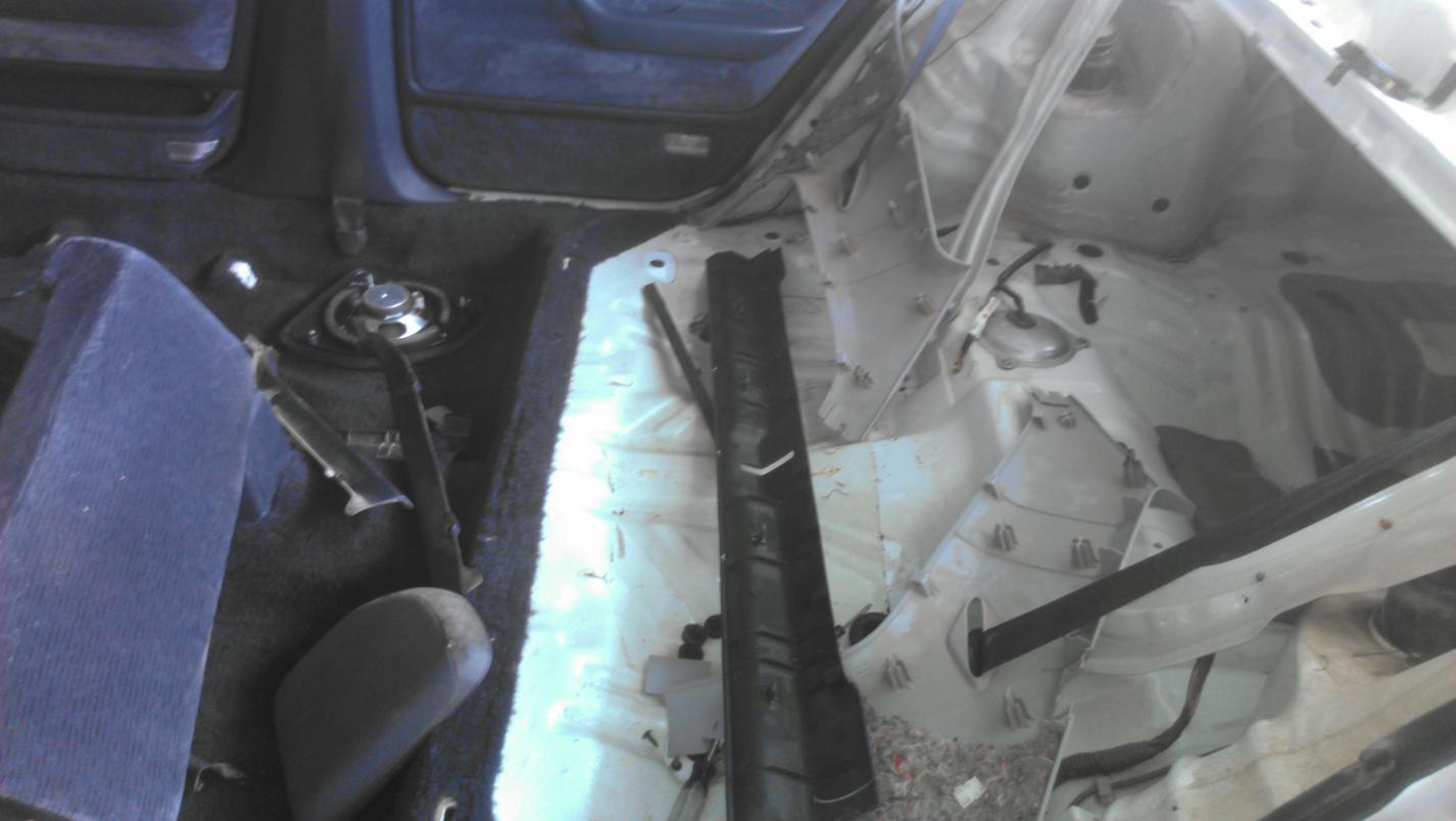

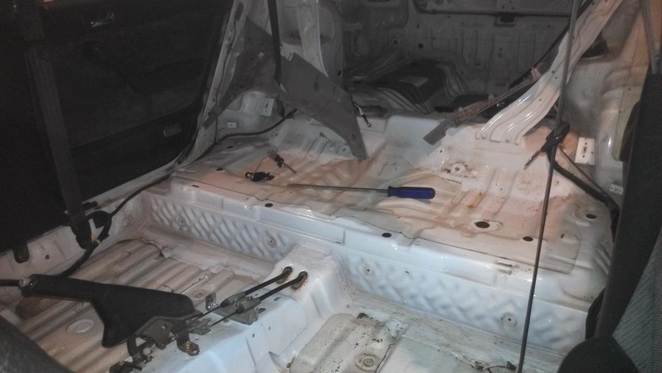

Had it sitting in the garage all weekend, took out the seats and everything else shampooable.
Had to back it out last night to put my wife's van in. Tried to start this morning and same deal. Turns over but no starting. You can definitely hear the relay click, and fuel pump run for a couple seconds. Which is easy to hear with no seats in the car and the trunk stripped down to nothing.

Attached Thumbnails RTH. 93 Accord Fuel Pump/Relay Issue-zpfile000.jpg   RTH. 93 Accord Fuel Pump/Relay Issue-zpfile001.jpg

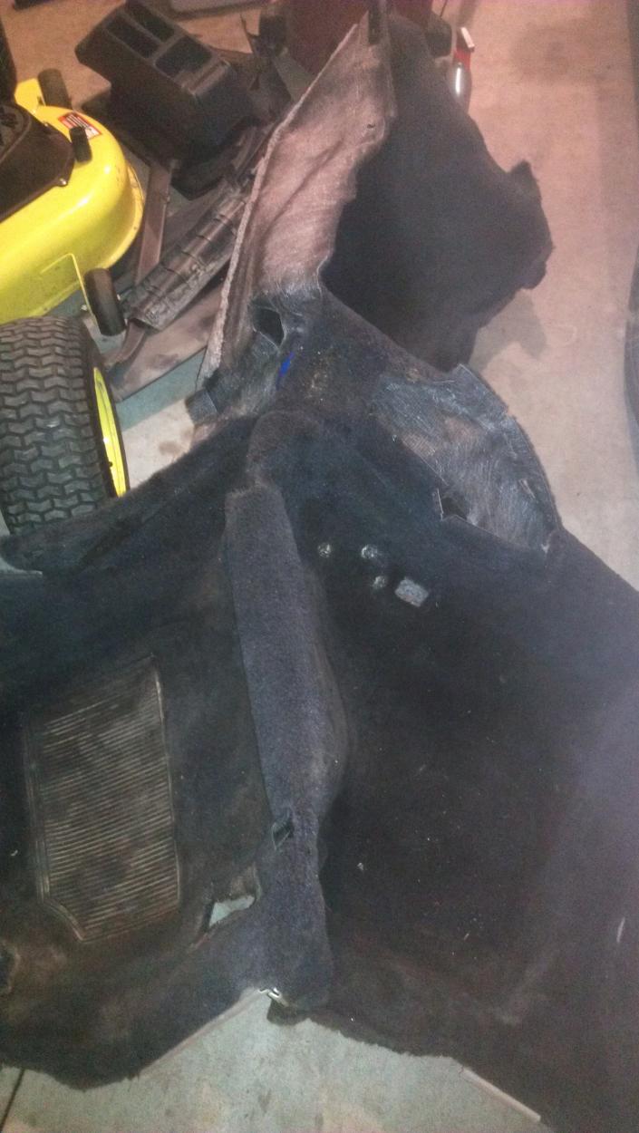

I did yank all the carpet out and plan to head to carwash shortly to power wash the living daylights out of it. I thought it might be just a little shampooing in place, but its getting a full-on power wash. If it falls apart, so be it. Yuck.
