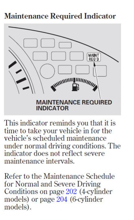

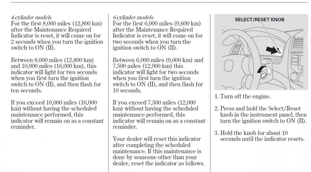

Here are the pages (attached) to reset the maintenance required indicator (if that is the light you are referring to).
I believe if you register at the American Honda site, you can also download a copy of the owner's manual.

the service engine light will come on when the computer tells it the car needs an oil change...so once you get it extinguished it will come on again eventually.

Thanks for the info. I had just changed the oil about 500 mi. before the light went on, now I have about another 1000 miles on it (1500 total). It probably needs to be reset. Thanks for all the help and input.
Much appreciated!
Makes a lot of sense, most new cars have an oil change indicator!!! Duh, sometimes I even amaze myself at how dumb I can be.
