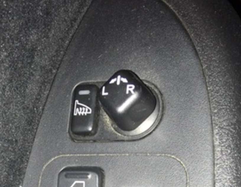

Thanks! Below is a photo my neighbor just took of his '04 mirror control. Notice the heated-mirror extra portion to the left of the ****. Does an '06 that has heated mirrors have the same switch?

Did the same search on part numbers for the switch and they have a different part number. The 04 ends in A01, the 06 ends in C01. Likely slightly different.

My neighbor bought the '06 mirrors. In short, they are perfect replacements for a small fraction of the price that Honda wants for new mirrors. As a reward, my neighbor treated my wife and I to dinner yesterday evening.
