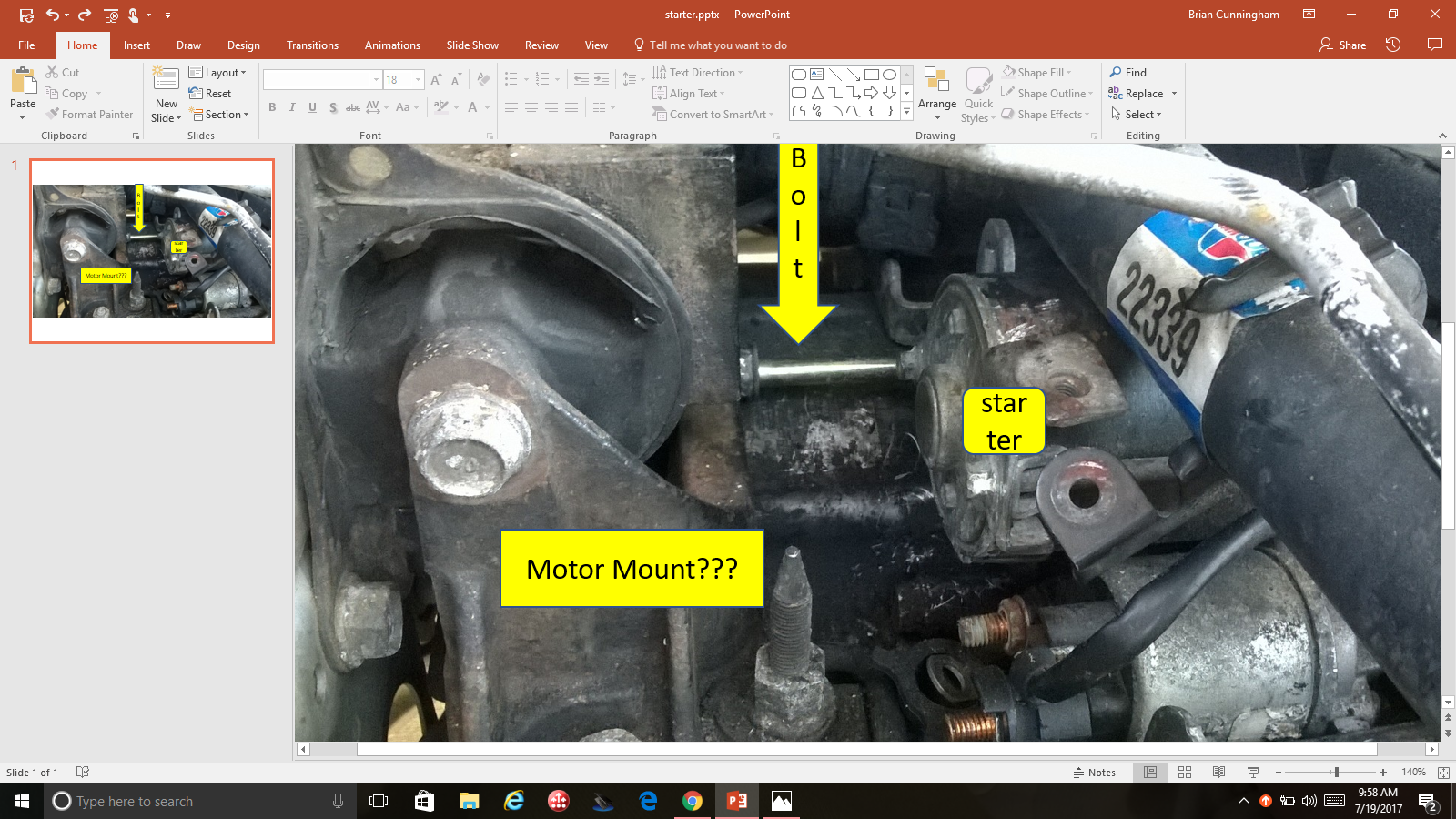

There's 2 bolts that mount the starter as you know. In the middle of the pic you'll see quite a long bolt (arrow pointed down). I can't get it completely out because of (what I think is but may not be) the motor mount.
Question:
Is this the motor mount?
Is this preventing me from taking the starter off? Tried loosening the starter but it doesn't want to budge. And I don't want to put too much pressure on it unless I break the car and myself! Thanks for the advice.

There's 2 bolts that mount the starter as you know. In the middle of the pic you'll see quite a long bolt (arrow pointed down). I can't get it completely out because of (what I think) is the motor mount.Question:

See attached procedure which says nothing about motor mount.
It appears from the sketch that bolt should be removed from the bell housing and flange and should allow starter removal even w/ bolt in starter housing.
Any chance this bolt is not the starter retaining bolt?
Suggest bumping starter firmly w/ rubber or steel hammer.

You were right. It was not the starter bolt. But now I have run into another problem.
