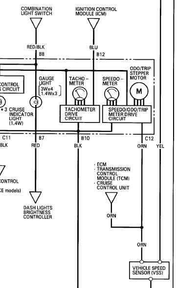

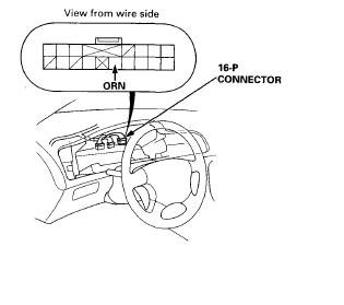

The orange wire is the "key" here. As TX said, there is a split some where between the orange wire from the VSS that goes to the ECM, TCU and cruise (why the cruise works and no CEL or TCU code) and then the other side goes to C12 of the cluster
Personally, rare a wire issue after that split would happen. Common, would be the circut board.
PLEASE let us know what you find.

Just as a follow up on Poormans suggestions. I did a continuity test of the orange and yellow wires from the vss. The yellow tests good to the firewall and the orange tests good up to the firewall and then up to the back of the gauge cluster at the 16pin. Thanks for the diagrams by the way, big help. I called an online gauge rebuilder and they said the " stuck on 20mph" is a very common problem and I need a new rebuilt speedo. Sooo as some others have advised me on the list already that is where it stands now. But first I need to try an exchange unit from the breaker yard cause they said thats all they can do for me cause I am past the 30 day
warentee. The dash is still a part so thats not a big deal at this point I guess. $160. for a used cluster gear that may or may not work when I could have had my original speedo rebuilt and other gauges tested for $160. with a one year warantee.
Wish I knew then what I know now. Thanks for all the assistance. We'll follow up.
