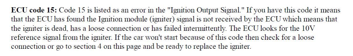

Fuel pump is circulating and working. After my super smart friend did some reading she located the ECM and 2 wire code plug. we jumped the wires and code 15 came across.

Code 15 usually is the igniter or wiring.
Attached Thumbnails Summer heat vs Honda..Put Questions In Here Please..-code-15.jpg

May still be igniter or wiring. Generally, the test of the igniter is for voltage and the igniter triggering signal.
I am not sure what resistance testing (i.e., ohms) you're performing?
