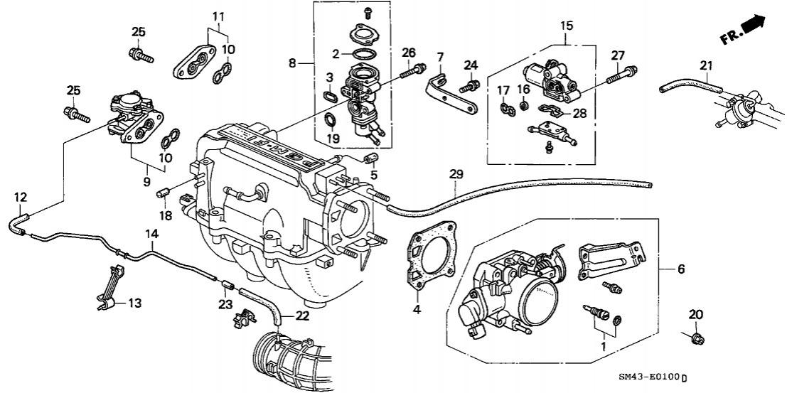

Idle-Air screw is #1 in the picture; it's above the bore of the throttlebody.
You've fixed the stop screw for the throttle butterfly plate? The plate needs to close as completely as possible without sticking wedged closed.
Vacuum leaks fixed?
You might have had to turn that screw (#1) in all the way in a futile attempt to get the base idle down. Now you'll need to open it a bunch, then unplug the IACV. This time if it doesn't stall immediately you can adjust it for 550rpm base idle.

You adjusted the throttle butterfly. THAT fixed the "vacuum leak". I'm guessing someone mistakenly used that to adjust the idle, throwing the whole system out of line.

  #17
Is the engine all warmed up?
ALL loads turned off? AC, headlights, blower, EVERYTHING.
When the IACV is unplugged, it won't compensate for ANY loads, so when the radiator fan decides to run that might kill it.
Old Apr 5, 2013 | 01:09 PM
  #18
Also...
1992 also has the boost valve (#9) over on the other end of the intake manifold. That participates somehow, but I never owned a 4th-gen so lets hope Poorman212 chimes in with some help.

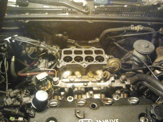

also, if it makes a difference i have the intake wth the spacer plate that has 4 extra intake holes with butterflies on em. not sure what its called...
let me see if i can upload pic now that im using a comp instead of phone
