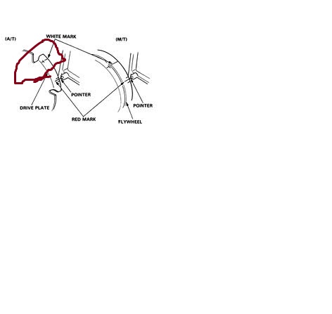

alright gentlemen, that is assuming, names sound like guys
i think i have a serious timing issue
when i can get the idle to 750-800 with iacv unplugged, i go for timing light, rotated dizzy all the way to on side, (toward the cab) only getting half way between white mark and red mark. actually, i cant even see the red mark yet.
how would one go about fixing this situation?
this pic is very elemntary, but the red circle is all i get out of the window with dizzy all the way one direction.

Are you checking the timing with the "service connector" jumped? If not the ecu is adjusting the timing as you are checking/adjusting....so you will be fighting each other.
Also, if the car is to op temp and you cover the lower port and the idle went down...just me but I'm thinking the FITV needs to be cleaned and adjusted....sounds like it is not closing off.

okay, i will clean the fitv in a couple of days when i can get gaskets. i will adjust now.
so what is supposed to happen when i cover the hole?
and yes i am using the jumper while doing timing, was wondering why your supposed to, thanks.
Old Apr 7, 2013 | 03:18 PM
  #36
Posts: 16,334
When the engine is warmed up, you should have no air going through the lower port that is controlled by the FITV. If air is leaking and you plug that leak, the idle should stabilize. It will probably be lower too.
Checking timing with that service connector jumped stops the engine computer from either advancing/retarding the timing while you try to adjust it.

You mention timing belt... Don't just move it a tooth... Check the cam timing marks to be sure where you are. You'll have to remove the upper timing cover. Look for the 2 dimples out at the camshaft sprocket teeth. They line up with the top surface of the head. The "UP" arrow never seems to be perfectly straight up.

ill have to wait a day or two to be able to adjust my cam and all that, cant really jack the car up and take that stuff on when its parked on the street down here.
but i did do all that last year, replaced water pump and timing belt, double checked all of the marks, even had a honda buddy triple check it for me. just wondering if it could be off, like a tooth. or what do i have to do to get those ignition timing marks back on track?
