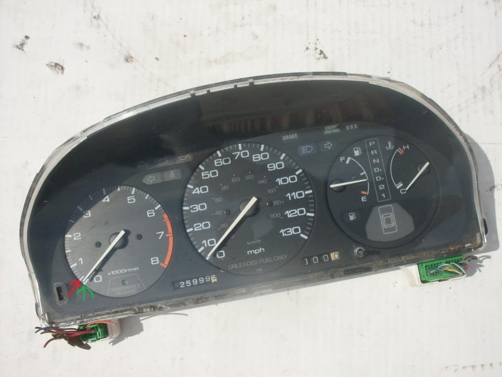

stupid question,
is the green line 0 and the red line 500?
aftermarket tachs look way less confusing
Old Apr 6, 2013 | 07:02 PM
  #29
Posts: 16,334
That is correct.
