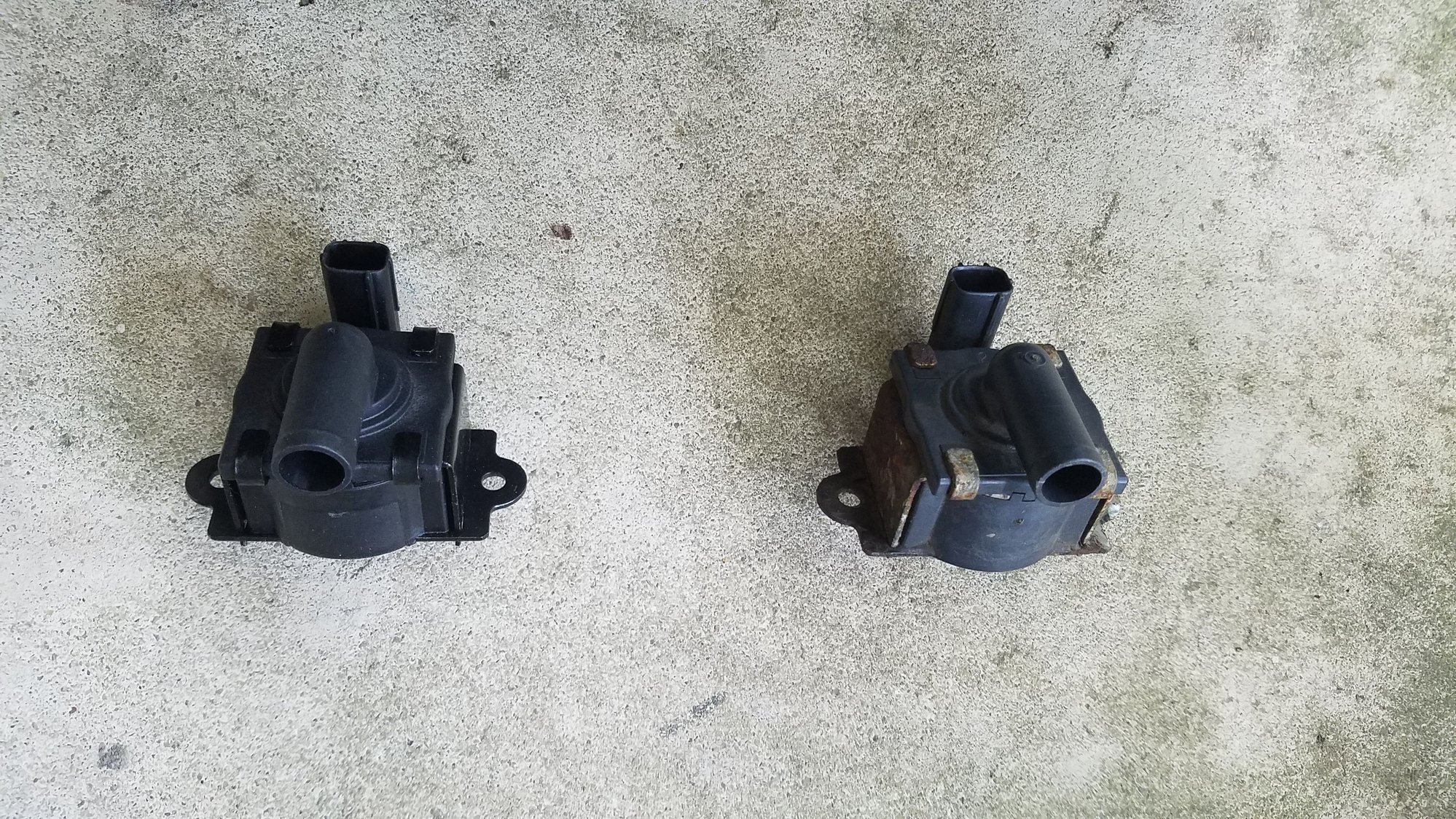

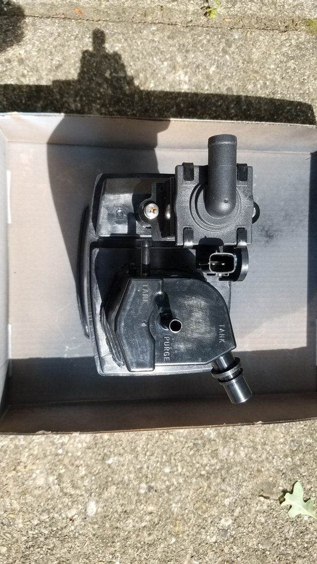

3. Remove the two phillips head screws holding the canister vent shut valve on. I did not take a before photo of this - sorry. Good luck with this if you live in the rust belt - try vice grips and be very careful not to snap the screw like I did. If you do then your choices are to rig something up or buy a new canister for about 60 bucks. I probably could have found some other way to attach it - but did not want to be bothered by more trouble if it didn't work.

thanks very much for your write-up, mygfdrivesahonda. i just had to perform the same maintenance on a 2002 honda accord and the details & pictures you provided proved invaluable. the honda i worked on is located in the rust belt, so i also ended up replacing the canister as the screws were corroded beyond repair. i soaked them in some pb blaster overnight, but it did little more than remove a few layers of caked on rust.

Hello. I know this is an old thread but I just pulled the canister off of my 2000 Accord, code P1457. I am in NJ and the car has 178k miles on it. The 12 mm bolt was not too bad but the machine screws were rusted. I sprayed them with Knocker er Loose. One came loose when i hit the edge with a chisel and was then able to turn with a screw driver, the top one. The bottom one no such luck. I am using a vice grip to turn it. It seems to be turning but it is not coming out. I will use a dremel tool to cut the screw and then attempt to get the rest of it out. This is good information on this thread.

Hello. I know this is an old thread but wanted to post an update. I did like mygfdrivesahonda and replaced both the Vapor Cannister and Purge Valve. The screws were too rusty to come off. I live in NJ. The total cost was about 95 dollars to include the Silicone Spray and new Phillips Screws.
