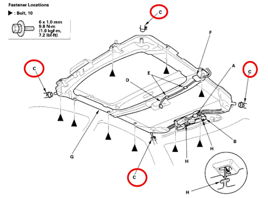

The roof does have 4 drains the fronts go down the A pillars and run behind the left and right kick panels, the rears are accessed through the trunk.
Here's an image.
Attached Thumbnails Water ingress into drivers well of 2002 Accord 2.3-sunroof.jpg

check front lef the sunroof hose. Riht above the dead pedal, it connects to the rubber grommet. If it disconnected, the water will flood the driver's footwell.
