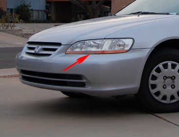

What are the yellow lights under the headlights called? see arrow in picture
I know it is the turn signal, but am trying to find the relay that turns this on and off. It is not the blinker relay (I think). It is on when the headlights are on. I think it is called something else when these are on at night.
Long story short... Last night when my daughter turned off the car and got out, those yellow lights under the headlights stayed on, even though she turned off the lights using the switch on the turn signal.
I went out there and fiddled with the switch, it didn't turn off. I finally got her remote and tried pushing the lock/unlock button several times and the lights finally turned off.
I was able to get those lights to be "stuck on" while the switch in the car was not touched, by using the FOB (model XT-59). So I know it cannot be the switch on the turn signal.

Incorrect. Many times you just make up things.
They are parking lights.

The Autopage RF-305 should have a green wire that supplies the parking light output (+). It may have a 10 amp fuse on that wire. If it does, take out the fuse.
From your photo, the Accord looks to be an LX or DX, since it doesn't have alloy wheels. For LX and DX, typically the alarm's parking light output wire is connected to the Accord's Red/Black wire (located at pin no. 18 of a 20-P harness connector located at the driver's side under-dash fuse box.

I was hoping it was a relay, but while I was down under the dash, the lights kept coming on and off, even thought no one was touching the remote. It had to be lose wires or bad connections. I just unplugged the Autopage RF-305. Hated to do this, but I can't let my daughter get stuck somewhere when I "think I got it" only to have another problem down the road.
