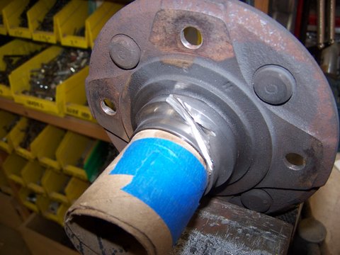

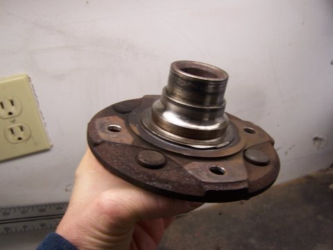

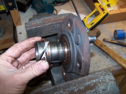

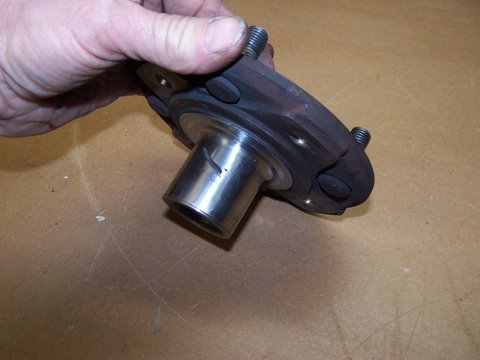

Was able to grind a diagonal slot in the outboard inner race without damaging the hub too much, then split it off -
Forrest

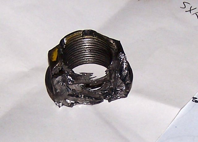

Passenger side axle nut wouldn't come off with 5' cheater bar and a 3/4" drive 36mm socket, Decided since I was replacing the wheel bearings and axle, just to chisel it off, paring it away.
