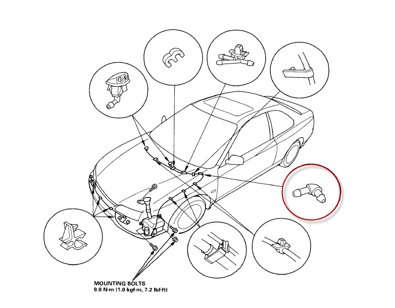

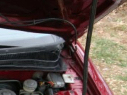

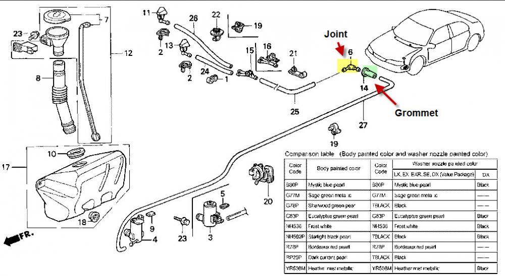

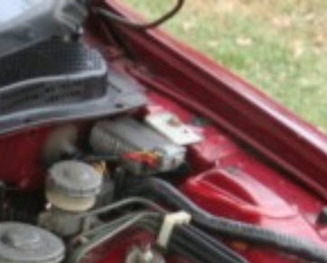

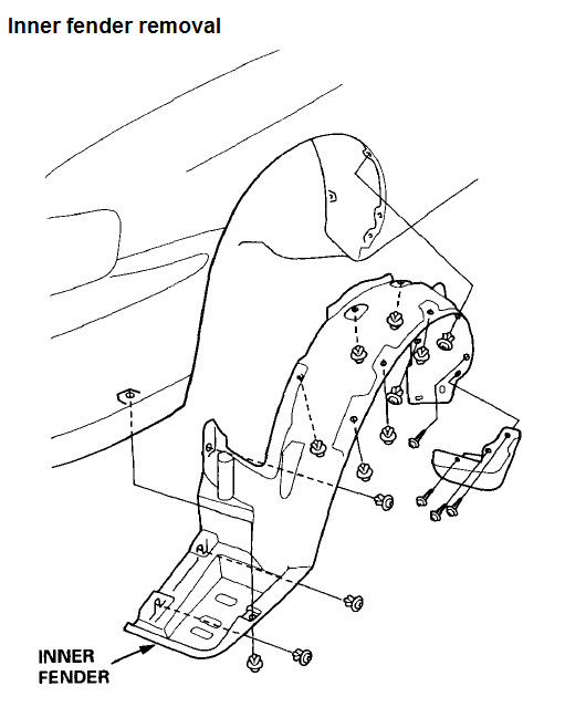

I no longer have my 95 Accord EX to check; but, it doesn't look like the cowl needs to be removed. I've attached a couple of pics. of someone else 95.
Based on the service manual, it looks like you have to remove the inner fender to access the joint. There should also be a grommet attached to the joint.
See attached pics.
