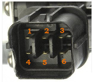

Did you try applying direct 12 volt power to the regulator motor? To try lowering it, apply power (+) to the #6 terminal and ground (-) to the #3 terminal on the motor plug. Only do so briefly, as to not burn out the motor if it is good.

Try applying direct 12 volt power (+) to #3 terminal and ground (-) to #6 terminal on the motor side connector plug. Only do so briefly.

I got to say, I don't know which ones are#3 and #6. Are you suggesting I run power from my battery + and -? I am sorry to say this is not something I have done before. Which is # 3 & 6? Your help is appreciated.

Apply 12 volt power and ground directly on the motor.

Posts: 7,101
I somehow missed this post of yours.
See attached pic. for numbering of terminal pins. Run power either from your car battery or a 12 volt power source. I use a 12 volt lantern battery for testing.
