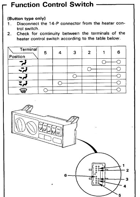

Ok, you have the buttons.
Then we need to check the mode/function motor and or the heater unit. On my 95, different gen just giving experience, the "levers" on the motor would bind every now and then. I had to lube them to get them going.

See if these pic's help.......I'm with pulling the "mode/function" motor - not sure if you tested it? - and see if you can move the levers in all functions....lube if needed.
