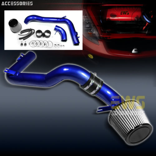

This is a pic of what I got online.
Attached Thumbnails 2008 V6 Accord Cold Air Intake Install need help!-%24-kgrhqj-lwe3jgsykeqbn0e7vjll-%7E%7E0_12.jpg

search on youtube
the installs are pretty straight forward. no directions?
most likely have to remove the wheel on the side the filter part of the intake goes. also remove the fenderwell lining to gain access to the airbox components to remove from the stock unit and to install the lower half of your cai.
