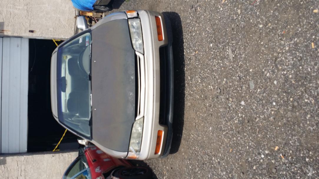

Wassup guys. I recently bought a 95 Honda accord Manual 4cly no-vetch with 13000. It was not well taken care of. but the clutch was recently replaced and that was my main concern as i am new at driving stick. I need shocks/springs all the way around. Header back and a wheel hubs for the front and a rear bumper. didn't buy if for that much and i really wanted it. It runs strong too! Im going to do a lot of preventative maintenance on it. and it will be my first time doing these things. i have help from other people i know, but I think it would be a good idea to look on here and learn from other peoples experiences. Looking forward to learning and sharing with you guys.
