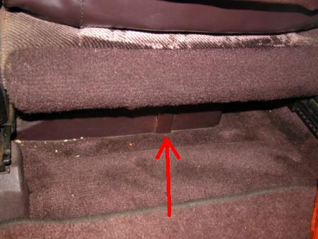

Ah, another 3rd gen (86-89) Accord owner....welcome.
Getting codes is simple on these. Look under the drivers seat from the rear. On the floor you'll see a "plastic" cover/box. Towards the center of the car you'll see a tab/cover thing. Pull it from the top and it will open. Then turn the key to on/pos II. Then watch the red led light flash. Count those flashes, count them several times you get get the right number.....there is a ~2 sec pause between codes or the same code repeats.
The number of flashes is the "code". So if it flashes six times then you have a code 6.
This is a pic from one of my 3rd gen's showing the ECU....kind of hard to see as it is brown on brown....The red arrow is showing the "window" you have to open to see the led.
